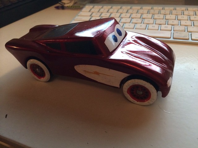

Here is a pic of the car we made last year (I did pretty much all of the work on it. My son didn't want to do anything to ruin it and refused to work on it for more than 10 minutes at a time)

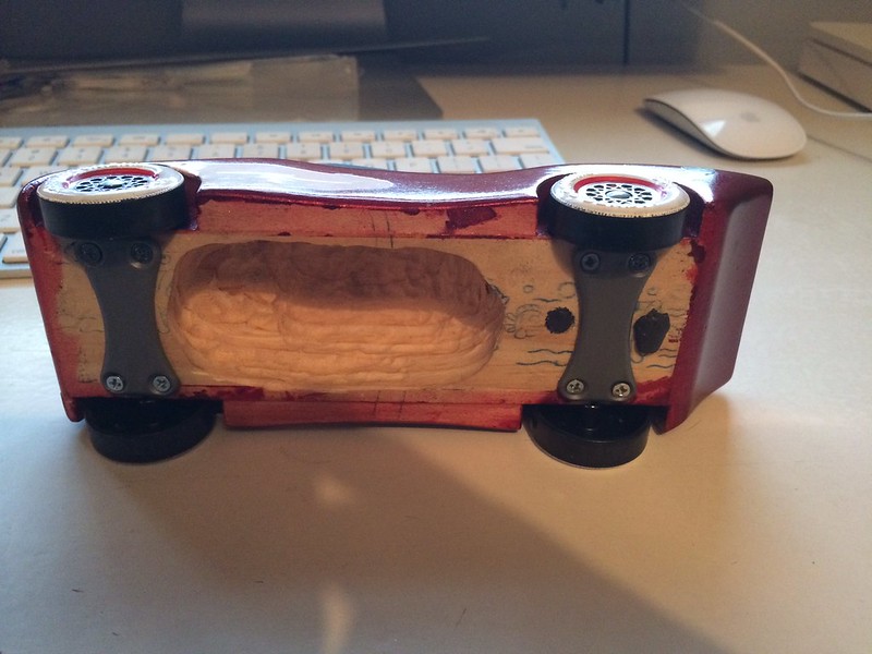

Here is the bottom. I had to do the same thing to the T-Bird to get it to make weight.
I covered the hole in the bottom of both cars with clear packing tape.
