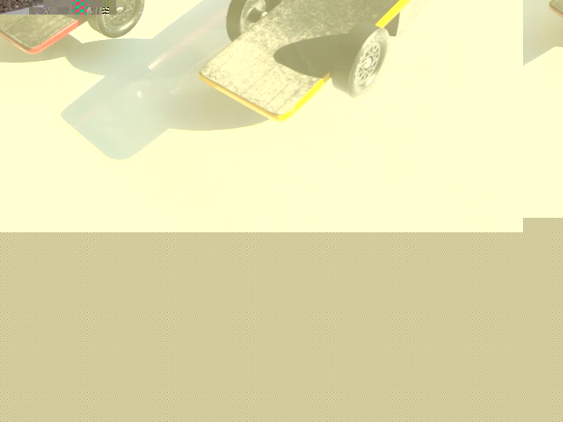

Both went sub 3 on my track (43' Best/27.1/ESS/K3) not sure it will be good enough only had about 20 minutes of tune time. I still have alot to learn to do a great prep on the wheels/axles.
Nice job. See the outside of the tread where the ridges are? There's a little fringe left on them from being lathed. You want to rub that off. I'll use my finger nail and kind of just scrape it off. They'll be faster. Be careful since you're already tuned. /images/boards/smilies/thumb.gif
Thanks Kinser, still need to find some time to be able to draft...lol next to you. This car does the same as the scout cars "gets faster in traffic" will be interesting if it does the same on other tracks.
I didn't spend to much time tuning (all I did is set drift on tuning table touched it up twice for wiggles then did 6 test runs), it's hard when you don't have a baseline time to tune toward. I'm sure it will be a humbling experience.
