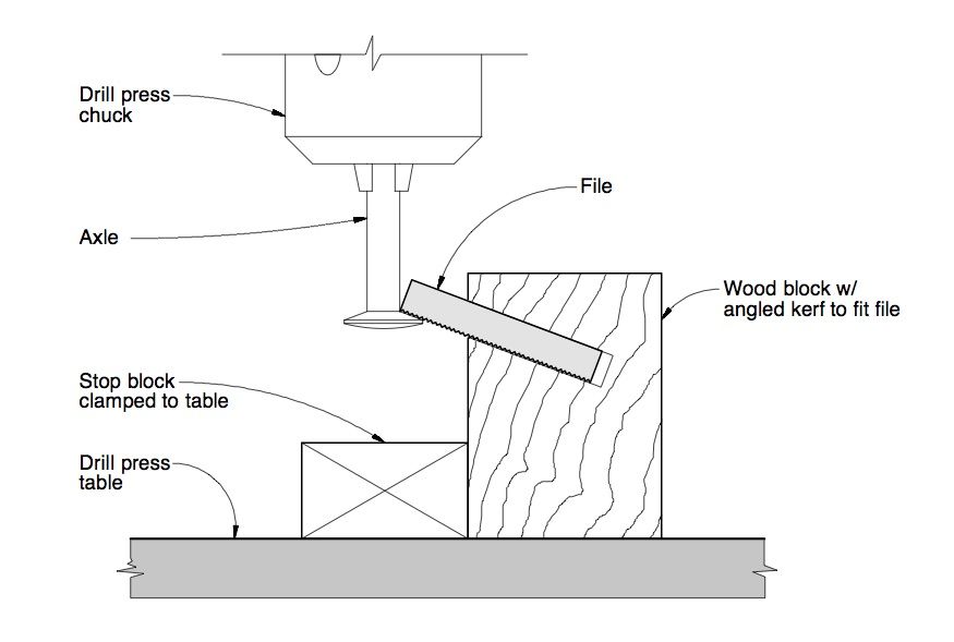

I don't have a lathe, but I do have a drill press. I made a jig to hold the file, which keeps me from cutting too much, and generally makes for a precision bevel. The stop block makes it easy to cut only just up to the axle shaft. I start by raising the quill up until the axle head barely touches the file. Then I turn it on and begin making passes. It's not a lathe, but it's quite a bit better than freehand.
