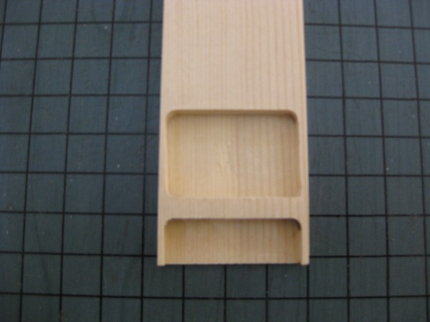

Can someone please post some pics of what is the best method on how to route out weight pockets for tungsten cubes to be placed in the bottom of the car. And second what is the best methods for attaching the weights to the car, so they don't fall out. Thank you so much for your help/images/boards/smilies/smile.gif
What tools do you have? (Dremel, router, drill, etc. This is one of those questions that can have many different answers depending on individual preference and tools available.

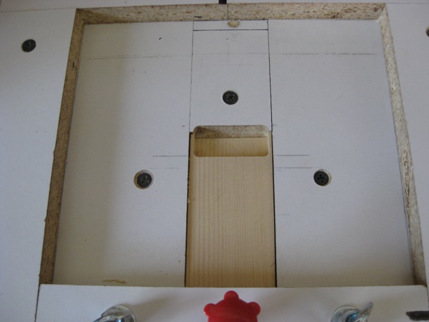

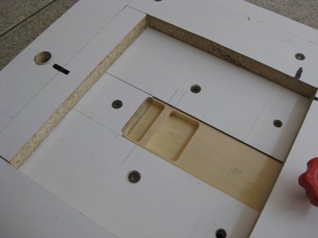

If you use a jig the Dremel won't get away from you. The area you are cutting is controled by which spacer is in the jig.
