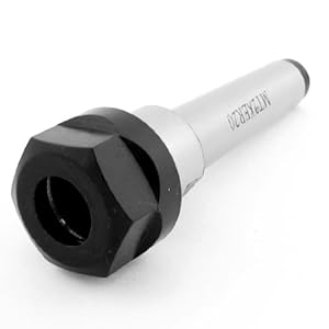

You could have just chucked the chuck and put in a collet holder instead! Search for ER collet and whatever taper your spindle takes (like "ER collet MT2").
I had thought of that, but collet holders for JT33 tapers are rare and really expensive. I did try a collet adapter (a collet holder with a shank that can be chucked in a 3 jaw chuck) - but that doesn't really solve anything as any runout from the chuck/collet holder connection is magnified by the extra length of the collet holder.

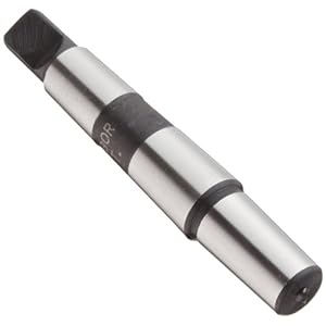

JT33 would be the taper of the arbor your chuck mounts on I think? You can't knock out the arbor and replace the whole thing? I hope it's not a Jacobs taper up in the spindle, it would be very short! You might have an arbor like this?
The few drill presses I've messed with have a slot in the spindle where you drive a wedge to knock out the arbor and chuck together. Then you can replace it with something like this:
Yes, JT33 is the taper where the chuck mounts.
Ok, I see where you are coming from. Unfortunately, my press doesn't have that slot. I'd have to do some fairly invasive surgery on the press to get the arbor out. Might still be worth it though, so I'll have to think about it.
