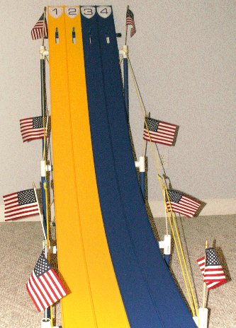

There's actually 4 lanes to this track and each lane is approximately 4" wide and curves up on each side so they form lanes...sort of looks like a giant yellow Hot Wheels track.
Our track looks like this (minus the flags).
